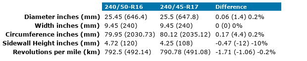

And - the 240/45R17 is only fractionally different circumference (ON PAPER) to a 240/50R16 so no ABS issues.
