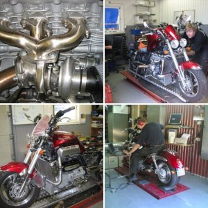

Nussekudden
This album posts what I think looks to be a fantastic kit, I have an inquiry in with the shop that designed and installed it, fingers crossed they can be convinced to do a few more!
Nussekudden
Did you contact the owner too? It looks like the images date from 2006 and he was last seen on the forum May 17, 2013.
Nussekudden
Found it! A bit of thread mining but I see @Claviger and @BigNorm have been gone since June/July 2021 too. ☹️
Not sure who if anyone who disappeared around then will re-appear or if all related.
Time will tell.
Album
Looks like the company set up a USA agent in 2007 - I have no idea yet what is happening now though. I
think you would need them to contact Sweden for details of the 2006 set up for Nussekudden.
