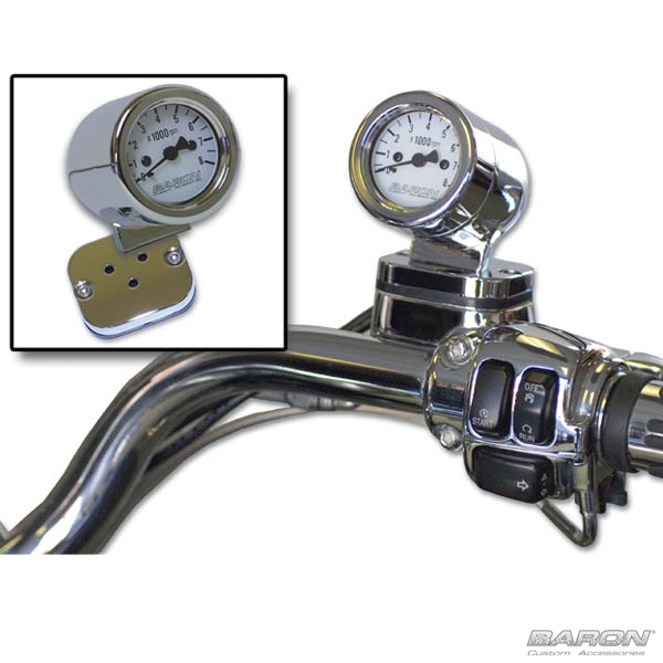

The barons tach look promising, at least aesthetically, coming with a decent-looking bar-mount pod, and in black or white face and 2" or 3" sizes
https://baronscustom.com/catalog/category/24/index.html
This is a pretty neat mount!
https://baronscustom.com/catalog/display/245/index.html
They list M/C covers for various Japanese models - would think one of them would be same fit as the Triumph
Maybe if you give the dimensions (overall size and spacing between screws) , their tech support could identify which would suit?

It's just a Nissin 5/8" master cylinder - these things usually have cross-marque applications
I don't KNOW that there will be one to fit, but worth checking
All moot if no-one likes that mount anyway! :D
