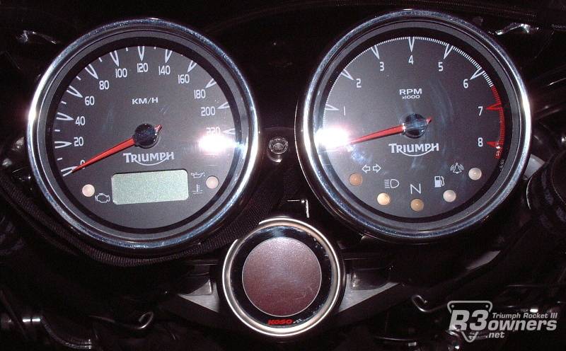

I use that last one below and between the stock dials. For something else.
It has digits and sweep dial - I quickly used the digits over the sweep.
Wont fit in a shell as it's 48mm not usual 55mm - KOSO use 55 and NOT 52 - be warned.

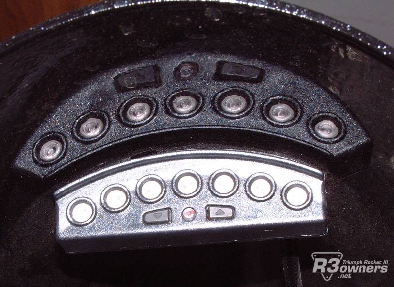

One option I've not mentioned - I use one and they're VERY VERY good for ease of eye-brain recognition is the SHIFT-i
Like my little KOSO it's coupled to a GPS speed sensor rather than the coils - but I'm odd like that.
https://ecliptech.com.au/shift-i/
It has 7 different colour LEDS - very configurable - I use mine as "Your licence is "OK, AT RISK, GONE" indicator.
It auto dims if you're constant cruising (configurable) but will then come bright to improve visibility.
REALLY it's meant to be a shift light - but - imo would be very good.
