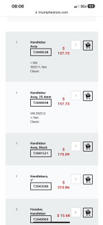

Hey Kevin, do you the know the Triumph part number for those classic bars you got? I bought a T2043580 thinking that was it, but they are exactly like the bars that are already on my Touring. Going to have to send them back. Back to square one. :confused:

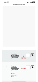

T2043580 should be correct. Touring stock is T2046700. Not sure what you got
