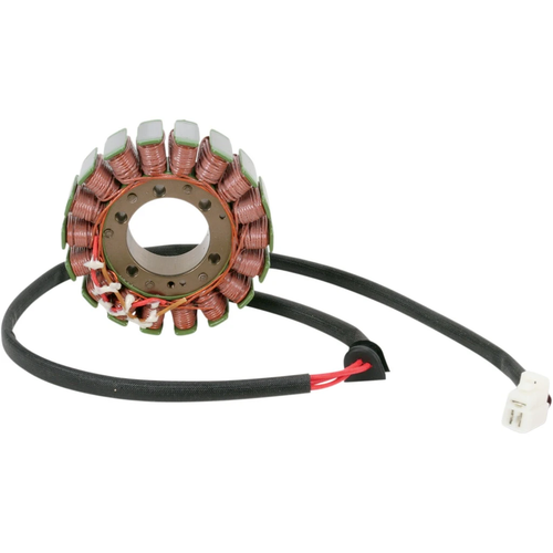

yeah just let me know where to send, im taking it not to mikes shop so i pulled back off shipping there and will hold until i hear definite where to send. I have the rotor tool and i have engine collar tools. Holding until i get address and to definitely ship.

i think he is correct that the stator is bad and u need to order.
if you have made a firm decision to come to tucson then i would have tools and parts sent here

US$140 vs your US$225 quoted for a Rick's Stator seems quite good and you cannot beat Hermes for reliability and service from all reports. :thumbsup:
Another amazing Triumph model wide cross fitting! I hope you got their good price too @sonny ;) :whitstling:😁
EDIT: SINCE CONFIRMED INFO WRONG, THIS IS NOT A R3 FITMENT!
Rick's Motorsports Stator for Triumphs - 21-001
This item fits the following models:
  • America 2002-2008
  • Bonneville T100 2002-2008
  • Daytona 600 2004
  • Daytona 650 2005
  • Daytona 675 2006-2010
  • Daytona 955i 2002-2006
  • Rocket III 2005-2010
  • Rocket III Touring 2008-2010
  • Scrambler 2006-2009
  • Speed Four 2003-2005
  • Speed Triple 1050 2005-2010
  • Speedmaster 2003-2008
  • Sprint RS 2002-2004
  • Sprint ST 2002-2010
  • Street Triple 2008-2010
  • TT600 2000-2003
  • Thruxton 2004-2008
  • Tiger 955i 2001-2006
  • Tiger 1050 2007-2010

kevin can u explain what u do (take off) to remove that cover to get to stator?
