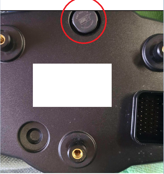

This is part which goes below/behind the instrument cluster computer of Rocket 2.5L

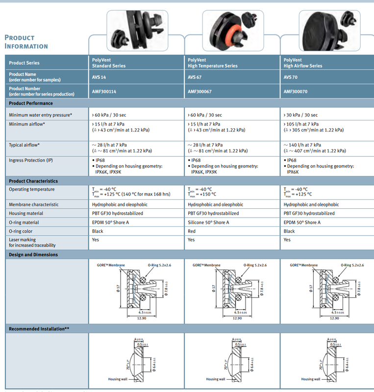

Exact same part and same company
AMF300114
So it isn't a sealed unit after all. The clear face is just sonic welded to the rest of the plastic and it breathes through the snap fit vent. I guess that keeps the rain and road spray out. Maight juast beez da vibrrrratttion dooooing themmmmm iiinn. 😨 Stress cracking the thin plastic.
