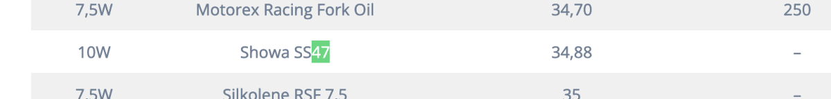

I'm probably going to just spend the extra money on the SS-47, but for those who want to go rogue I found another chart that does list SS47 along with viscosity at 40C.
Going by that metric you might consider one of these other brands with similar viscosities (above and below).... Notice the discrepancies in viscosity between these two charts - Showa SS08, for example (WTF 🤷🏼‍♂️)

Journeyman is spot on with this. Showa SS47G is considered a 10w oil. BUT, one brand 10w oil can be waaay thicker than another brand. What you need to match up is the Centistoke (CST) value, which Showa SS47G is rated at 34.88, as above.
This 34.88 is of much more relevance than a 10w or 7.5w from a particular manufacturer, because it's a specific standard. If you look at the above chart, you'll find some 2.5w are thicker than 5w or even some 7.5w oils. and some 7.5w thicker than 10w. You can see the issue here of going by what a particular manufacturer says the weight of their fork oil is. Use any oil weight that gives you the base line of 34.88 CST and you'll have the 'right' viscosity of oil. A range is also acceptable, you don't have to get it exact, close will be fine, as in 33 - 36 CST & you'd never feel the difference. So, use the CST rating of the oil to find out what viscosity you're actually putting in there.
