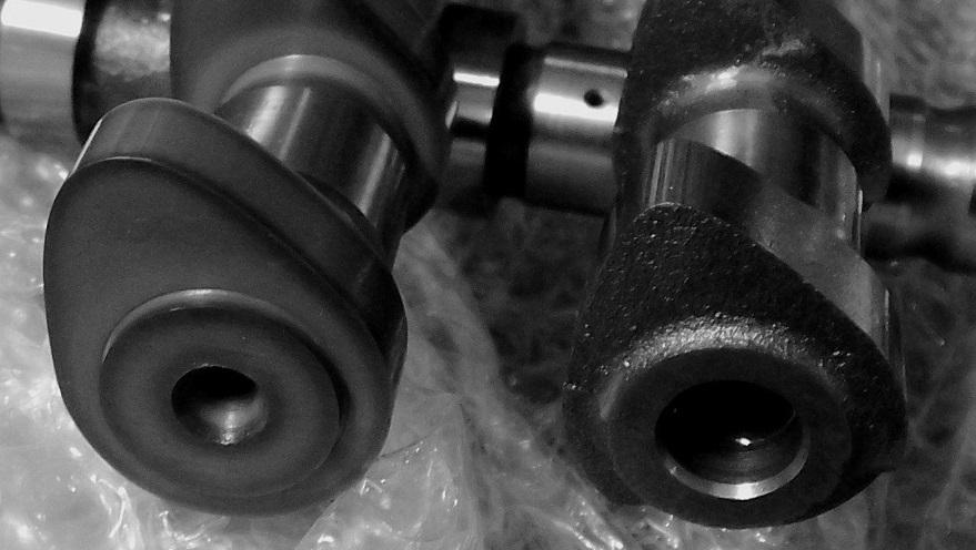

This cam (left vs stock) works well at least up to 7000 rpm with stock valve springs, retainers etc.
Prost
Ulf
Who is the manufacturer of the left cam? also do you have any horsepower and torque figures for this cam with intake and exhaust mods?

It is just the intake cam. We used it with stock outlet cam and modified cam timing.
With high compression pistons and a good full exhaust system you will get about 180-190hp/6500 and 180-185 p/f (240-250Nm).
Depends on how you adjust it.
We made it.
