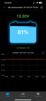

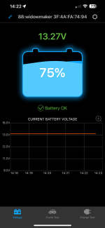

Exact same thing happened to me. Mine is ridden every single day on my ride to/from work. Last year it wouldn't start at work because the battery was too low. I believe either the battery or charging system is slightly under-sized on this bike. I installed a Bluetooth battery monitor and could see that the battery charge state would slowly decay day after day (even with continuous riding). I installed the triumph kit that adds a DIN charging port to the left side of the bike and now use a tender about once a week to ensure it's topped off. No problems since and the battery monitor keeps reporting 99-100% charge state. I've gone through 3 OEM batteries on my 2021 so far. I've been tempted to go the Lithium route, but I'm having a hard time finding one that has the necessary CCA and capacity and is sized correctly for our battery tray.
