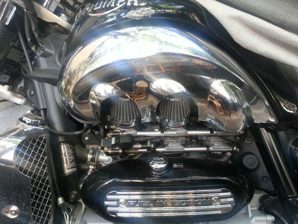

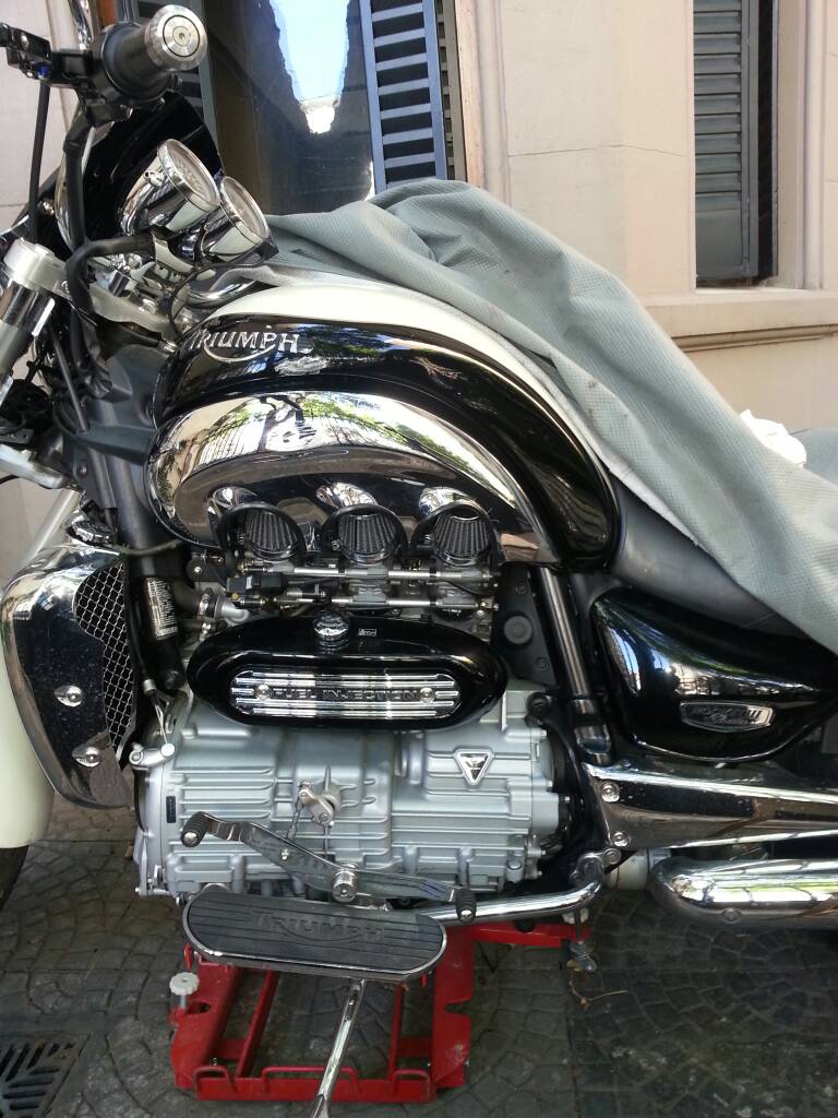

Pic of Triple K&N's Under Bearclaw
Thank you again for your help, now I ll ry to finish my work here are some pics
will finish when I have more Dremmel saws I ran out and put some rubber finish also
Finished

Just put the ru 2780s on and replace the bear claw as is. Everything will fit and work out just fine.
The temperature sensor sticks into the manifold and measures the air going into the throttle bodies. When you take out the manifold and install the filters you need to move the sensor as close to the filters as possible. Between the front and middle filter zip tied to the fuel rail works.

Thanks dougl. I think I've seen a photo of an air temp sensor actually sticking into the top of one of the three K&N 2780's, ( not zip tied between two of them ). Is that overkill, and completely unnecessary? Or, perhaps a good idea? And, what about venting the crankcase? Is there a better place to vent it from? Or, just stick the K&N crankcase vent filter on the vent spout, behind the plastic panel, on the lower, right hand side of the bike? Just trying to learn. Thanks.... Russell

Overkill, IMO. The vent filter fits fine on the spout although it's a bit hard to get it on if you have big hands. Check it periodically.
