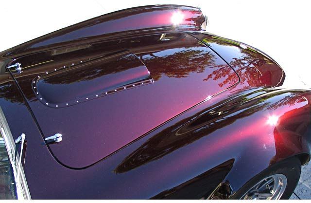

Candy Black Cherry is nice too.
That is a beautiful paint job, far more complex than I'm going for.
