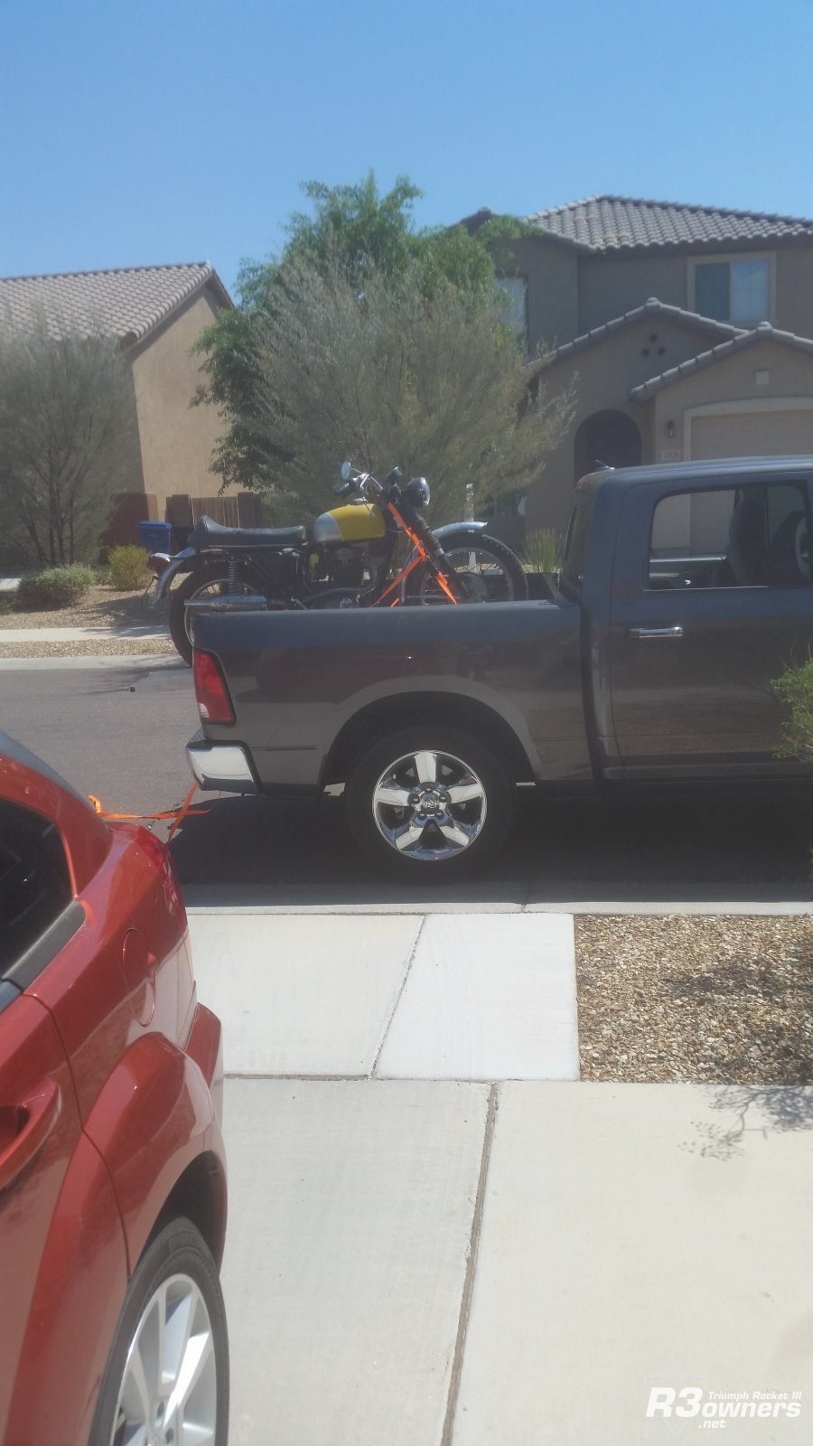

Looking for a rack to carry my R3
Are you 100% sure about that? From the Ram website for the 3/4 and 1 tons:
The recommended tongue weight is between 10 percent and 15 percent of the gross trailer weight. However, the maximum tongue weight on Class III (the bumper ball) is limited to 500 pounds, and Class IV (the receiver hitch) to 1,200 pounds. Additionally, the GAWRs and GVWRs should never be exceeded.​

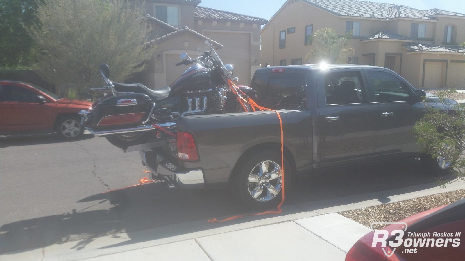

Class V rated at 1200Lbs. As has been mentioned, the R3 weighing close enough to 1000Lb, the first decent bump and she'll be gone. The downward force of that kind of weight, even driving slowly over a bump, will far and away exceed the rating of the hitch. I paid $700 for a trailer solely for hauling the bike. When you look in your rear view mirror and see the transport truck rolling over what's left of your bike you'll think a trailer was a good investment.
Just my $0.02
Since 2003 for my vacations I've been carrying Gold Wings, HD Baggers, my Triumph Explorer and now my new-to-me R3 in the bed of my 2001 Chevy 1/2 ton pickup back and forth from British Columbia to (initially) San Diego and now since 2011 to my winter digs in Mesa, AZ. 10's of thousands of km's over the years. I bought one of these in 2003 (not my truck or photo)
Mine is silver, is very well made and folds in half to lay beside the sides of the bike while in transit AND/OR can fit behind me in my extended cab. I bought mine off their eBay website at a discount. It folds nicely out of the way when at home in the garage. I made a wooden chock for the bed of the truck for travel. Loading it isn't difficult because going forward and having your feet on the side ramps feels safe and when I take it out of the truck (wherever my destination is) I just look for a place where the trucking is angled down to the rear (at a curb or sidewalk at my motel) anywhere to reduce the angle of the ramp and I roll it back off. Going backwards takes a "little" guts the first few times but there is nearly always someone to assist. I've driven a few times to dealerships where they'll let one or more of their young employees help me as a courtesy to a rider. I'm 5'6" tall, 66 y.o. and have NEVER come close to dumping my bike. Maybe when I get old ;) I won't be able to do it but so far it's worked great AND seeing your bike safely in the truckbed for a long distance is comforting!

Thanks for the post. I ended up getting one just like that.
