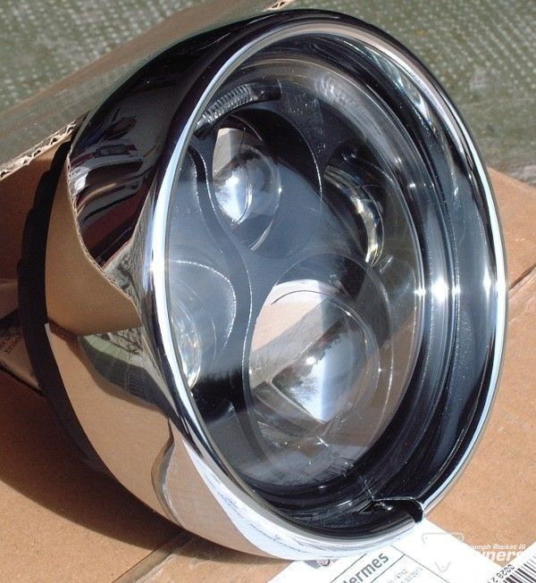

OK - To adapt JW-SPEAKERS - Get thee a set of rings like these
full
I went for Harley ones
(iirc Headlamp Trim Ring-69623-99A) http://www.harley-davidson.com/app-content/service/isheets/-J01601.PDF
as:
1) Cheaper.
2) come with rubber anti-vibe gasket.
You cut back the inner edge (the bit that rests on the lens front) by about 12mm/1/2". I have an end mill and used a diamond coated cutting disc - but I'm sure with a steady hand and a dremmel it's possible.
full

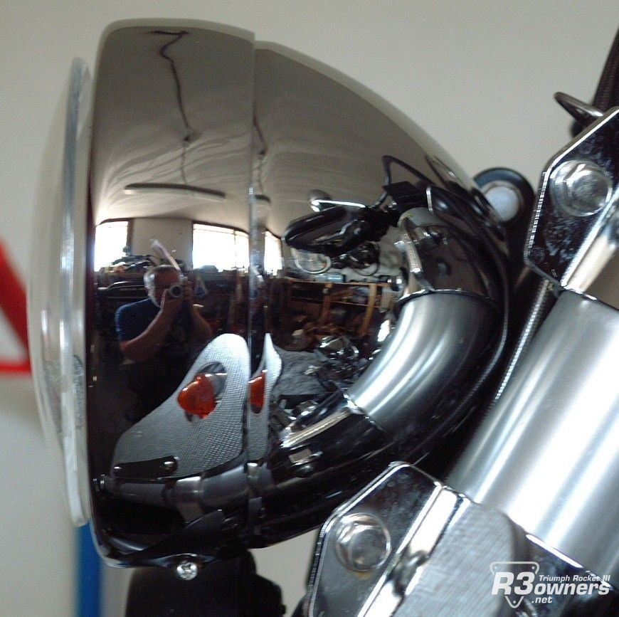

Remove old ring and glass - push Speaker in against thin metal locating plate (square it up!) - fit new rings over - and Robert's your Aunty's live-in lover.
full

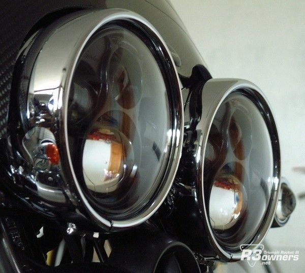

With CEE-Bailey glass protectors on as well.
As a plus - I think they look more streamlined too. But Function came before form. And (importantly for me) reversible.

Damm shame because I think the Daymakers my be a tad better (Can't prove this).
I hope to get a set of the 8630 to test for comparison.
Anyone with these in the Seattle area interested?
Has to be done after astronomical twilight (about 90 minutes after sunset) and takes about an hour.
VERY sweet mounting work on those headlights, Gray Beard!
Damm shame because I think the Daymakers my be a tad better (Can't prove this). VERY sweet mounting work on those headlights, Gray Beard!
On DIP I doubt it - as they have EU approval and there are some really tough restrictions for EU approval - esp relating to DIP beam. Main you may be right as the chip configuration differs. The one to also test - is the new Rivera Primo HedLed Phase 3.
