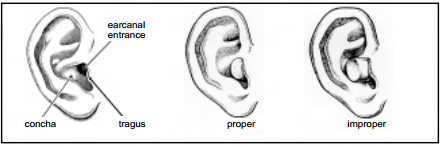

How to Fit Disposable Ear Plugs
1. Roll the ear plug up in your fingertips for a few seconds until they are compacted into a cylinder shape.
2. With your free hand, pull back on your ear before you insert the ear plug. This will straighten out your ear canal and allow you to more easily push the plug into your ear.
3. Push the plug into your ear until the plug sits almost flush inside (pictured right). You don’t need to push the plug in as deep as it will go and you may actually feel some discomfort if you try and do this.
Allow some time for the plug to expand, it will take a few seconds to fully expand and you should feel the ambient noise slowly silencing.
Once they are fitted you can check if they have a good seal by cupping your hands over your ears. If you notice a considerable change in ambient noise then you may not have the best seal and you should try refitting them.
When taking them out be careful not to pull them out too quickly. Ear plugs can create a small vacuum when removing them too quickly and you can put your ear drum under strain. Pulling them out slowly while twisting them is best practice.
