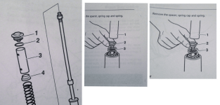

Beware when reinstalling the spring cap. The orientation of the spring cap in the manual is not shown consistently. On pages 14.10 and 14.15 it shows the spring cap turned so that the smaller part goes into the spring. That way the spacer fits in a shallow cup formed by the larger side of the spring cap. This is correct. But on page 14.13 it shows the spring cap flipped so that the wider cup part fits over the spring and the smaller part goes inside the spacer= wrong. See photo of pages from manual- picture at left is wrong, other two photos show the correct orientation for the spring cap.
