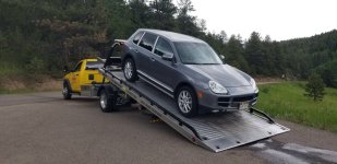

Had my 955 cayenne get stranded 15 miles from my home, took 3 days to get a tow truck to get her.
It happens

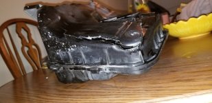

Yep. I the coolant tank exploded violently and we were supper lucky that there was a driveway we could pull over into. We were in the canyon roads.... 20220612_125036.jpg 20220614_183710.jpg
