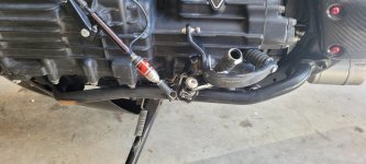

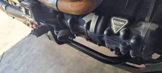

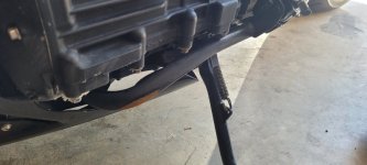

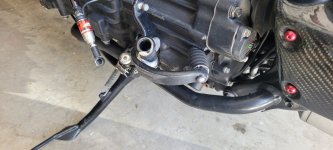

A Labor of Love; aka building a Rocket III Speedster
I've got a left hand foot rail laying around...
