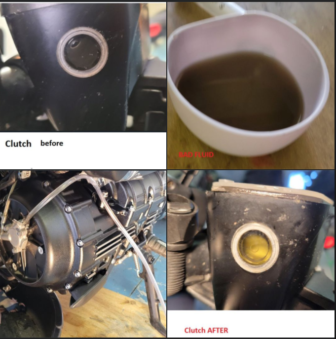

Clutch fluid is also a time consuming job
Wow! How many km on that clutch fluid? That looks nasty.
My Suzuki SV used to do that with it's clutch fluid. It was shown to be a design flaw. The slave cylinder seal was drawing chain lube and muck in, each time it retracted.
18months and it went bad, km are irrelevant here because brake fluid/clutch fluid once bottle opened goes bad within 2 years as it absorbs moisture because of temperature variation. perhaps this one which I changed should last longer
