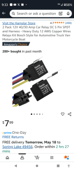

I did that too. It worked for awhile. The bypass relay I believe is the permanent fix. Mine hasn't clicked once since I did that, and that was all I did.
Prior to that (going back a couple of years) I put on the big battery cables, put a rebuild kit in the solenoid, put star washers on all the connections. Everything helped to a point. The fellow who wrote the procedure for the bypass, says that the bypass is all you need.
