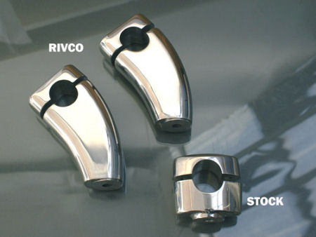

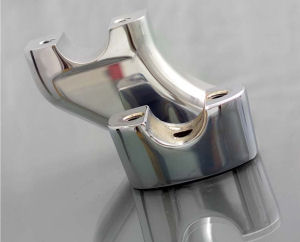

Chrome handlebar risers by Rivco for the Triumph Rocket III
Brings the handlebars up 1” and back 2” to reduce back strain and allow for a more relaxed style of riding.
US$182.95
This picture shows the Rivco riser compared to the stock riser.

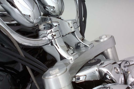

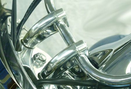

R3 Touring single headlight version.
Rocket III Touring Model Risers
While it may not seem like a lot, 1" up and 2" back towards the rider gives you a much more upright seating position rather than reaching over the gas tank. This will significantly reduce back, neck, and shoulder fatigue. These risers are machined from billet aluminum and are triple chrome plated. They use the original hoses and cables with only minor re-routing required. Custom made for the Rocket III Touring Model!
