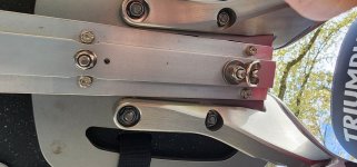

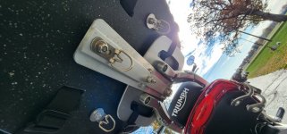

I might have to do a post on this topic, but this was my solution to a proper fitting tail bag. I bought a Nelson Riggs Sport tail bag and used a hard black cutting board from Wal-Mart to create a rigid platform for the bag. I made a slightly undersized template of the bag and a template of the small luggage rack on the bag template. I used 2 pieces of aluminum to make the mounting bracket and used 4 nylon bushing on the one bracket to trap the bracket on the inside the corners of the luggage rack (as shown with the arrows). This trapped the board and mount in position. I cut slots the board for the straps and put a front stop board on the mounting board to keep the bag from moving forward into the backrest. Easy to remove and solid. I also left the second piece of aluminum longer for support and added some D-Rings for hooking elastic ties. I might buy the slightly larger Commuter size bag which is only about 1 inch bigger and expands taller, but it should still fit just fine. if not, I have another board I can make bigger if I need. I think you can get the idea from some of the pictures.
