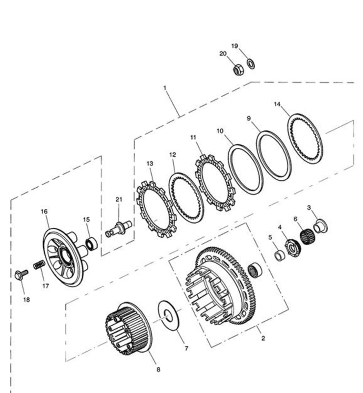

when you get chance, can you ask them which part # they will change from below:
