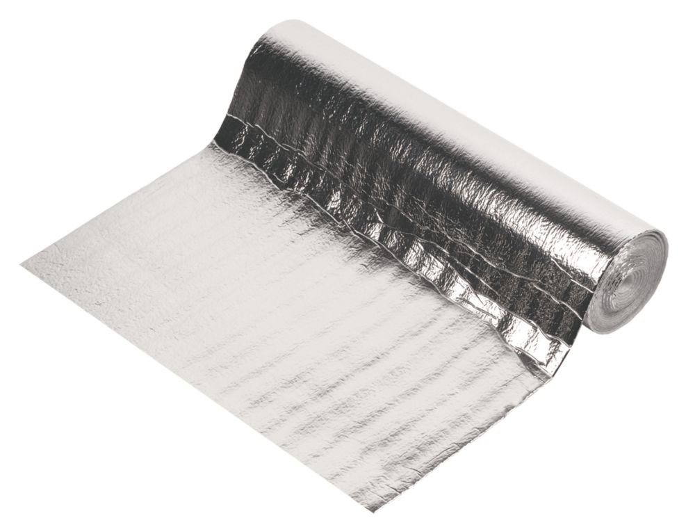

You could try some of this. Remove the cluster and stick this to the back
I've used it on a KTM Superduke and recently put some behind the header shields on the Rocket. It's really cut down the heat to the legs but it's starting to peel off the inside already. I gotta do some more playing around with it
Interesting suggestion. Thanks for your input.
I just had a look at what options are available in this field and came across this website:
Gold Reflective Heat Resistant Tape 2 Inch from Merlin Motorsport
