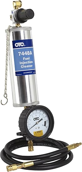

Rather than pull the injectors to clean or replace, I have used this tool from OTC a couple of times with good results. Don't own one but a chum of mine let's me borrow his when needed. I imagine some auto shops would rent them out.
You disable the fuel pump circuit, tie into the fuel rail (blocking flow back to the fuel tank) and provide concentrated injector cleaner to the injectors with the engine running. The engine will run on the cleaner by itself since it is petroleum based. You fill the canister with your choice of concentrate, pressurize the canister with air pressure, set your regulator to the prescribed fuel rail pressure and start the vehicle. Let it idle until the bottle is empty (may take 1/2 an hour or so). Relatively simple to use and cleans the injectors a lot faster than diluting the concentrated cleaner in the fuel, going through possibly several tanks of gas before things run right.

Hey it's pretty easy, I didn't pull any fuses cause I think it won't start without the fuse, plus I'm not the greatest at reading diagrams, thought it was easier to block the hose. Although that tool looks like it would be better. Does anyone have a Link for the tool, canister filled with carb cleaner and hose contraption/injector cleaner??? Guess I can do a search. There's 3
OTC 7448A FUEL INJECTOR CLEANER, CANISTER-TYPE | Tool Discounter
