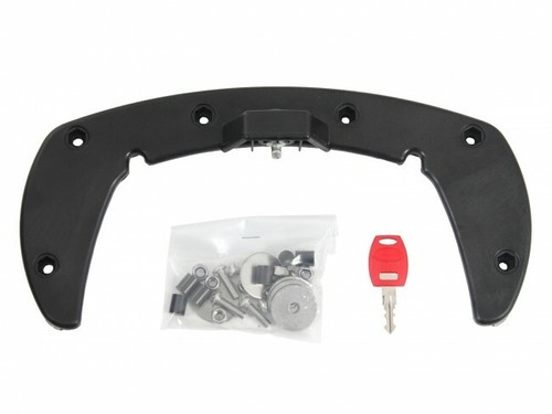

Sounds like someone needs to duplicate the female side of the bag brackets (Triumph or HB) so we can mount whatever bags we want. Unfortunately, that is outside of my skill set.
Update: Found this, the "female" part of the HB C-bow system. $120/pair and you could mount any smaller bag/shell you'd like.
Find many great new & used options and get the best deals for Hepco Becker C-BOW Side Carrier Plastic Mold Mount at the best online prices at eBay! Free shipping for many products!

I doubt there is an equivalent for the Triumph bags, but someone here could surely replicate the receiving plate on the back of their bags. I'd like to see a photo of that.
Can someone share a photo of the back of one of the Triumph bags + a closeup of the lock connection? I'd imagine that the lock would be the hard part to replicate, or is it just a glorified seat lock mechanism?
