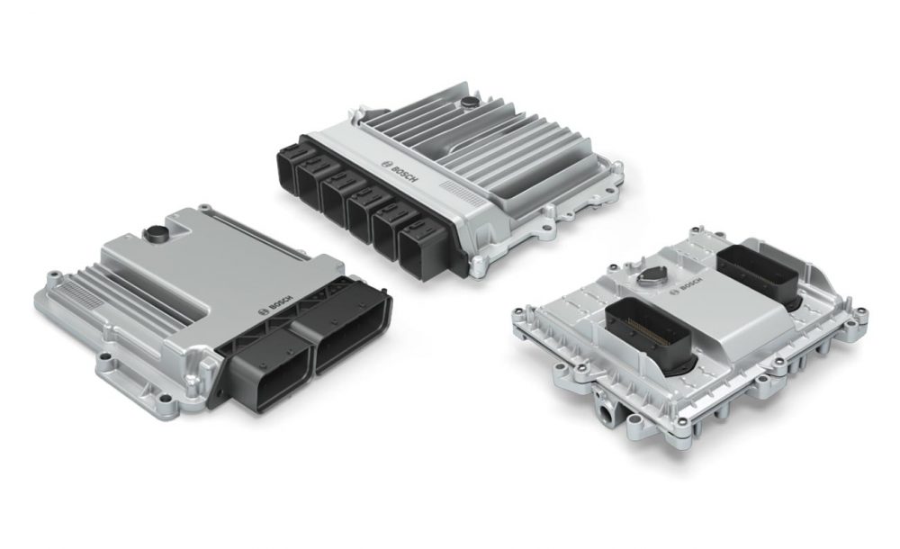

Some information on most all ecu's
They sre practically bullet proof.
They are made so that they will check there own circuits for example take the stepper motor if it has an open then it can set a code number for an open circuit if it has got a shorted circuit then it will set code for shorted circuit and just because that circuit is shorted doesn't mean that it will fry the ecu.
Most all the circuits in the ecu are protected from fools like me from touching a positive probe to a ground ecu.
Most ecu failures happens at the ecu grounded circuit probably because of bad solder joints.
Sometimes you can take the bad ecu ground wire and furnish an out side ground for example on an old Ford the ecu ground for tps, map and several other components failed so we took the grey with red wire and tapped into it and went to a good engine ground to repair an ecu that could not be found. On a chev we repaired a fuel pump ecu ground.
We also furnish positive and negative Voltage to ecus to test the ecu's however you cannot furnish a ground to coils ect because the ecu is doing that.
On the starting system the ecu checks all of the starting safetys the neutral, clutch switch ect then sends a signal from the ecu to the the starter relay to energize the relay so it is possible to furnish a ground to pin 85 and bypass all safetys.
If it is in gear it will take off.
Hope this helps
