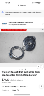

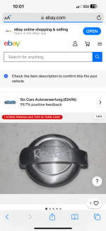

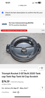

Stripped flat head screw on radiator cap, if I drill the head off, will the cap come off? Then I can unscrew the rest with pliers.
That cap is very soft metal
I would suggest maybe pliers or screw driver to bend it up so the screw will clear once cap is off then maybe you can remove the little screw straighten the cap and reuse
Mine was leaking and I took a some pliers and with hardly any pressure
I bent the tabs and is still working good.

The new rocket caps are not like the old soft metal ones, its a big chunk of a thang like a plastic or something
My phone does not have the year
Maybe put a soldiering gun tip on the set screw and melt it out.
You know we are guessing because we never strip threads 😂lol
Not a suggestion, just telling you my experience. When took my cap off the first time I didn't know about that little screw, so I just forcefully twisted the cap off. So I just bent the screw back after taking it off and realized that it was there. I think Triumph purposely used a soft screw; so it will bend and give.
