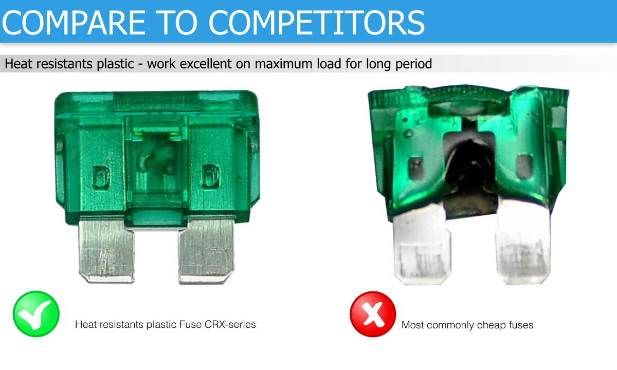

This fuse was changed in July last year and had semi melted .....
When you say "semi-melted" - do you mean the plastic body of the fuse was melted and distorted?
Like this:
When a Fuse blows from over-current condition (normally the circuit has experienced a momentary short to ground) then the internal fusable link simply opens, with no visible external damage to the body of the Fuse.
However if the plastic body is melted (like images above), that is from ongoing heat condition - although the quality of the fuse itself might be questionable, this is primarily caused in the first instance by poor connectivity of the fuse blades in the socket - a high resistance joint creates a volt drop across the fuse and an associated generated power which is expended as heat.

How can you tell if the fuse is a good quality one with hi temp plastic?
So that seller is essentially saying their plastic is better, so you won't have the problem - the REAL problem is not having the heat to begin with, rather than a Fuse that can withstand higher temperatures.
Fuses should NOT get hot!
Again, if it's getting hot, the source of that heat has nothing to do with the quality of the plastic, but to the quality of the connection between the blades of the Fuse and the sockets it sits in.
The sockets could be simply oxidized or they could be weak in their spring action, causing poor (high) contact resistance.
