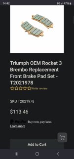

That's what I ordered from Revzilla and they're only $44 a pair but I don't want to deal with what you're talking about. In my experience the cheaper pads don't tear up rotors like the pricey ones do.
Definitely pricey
