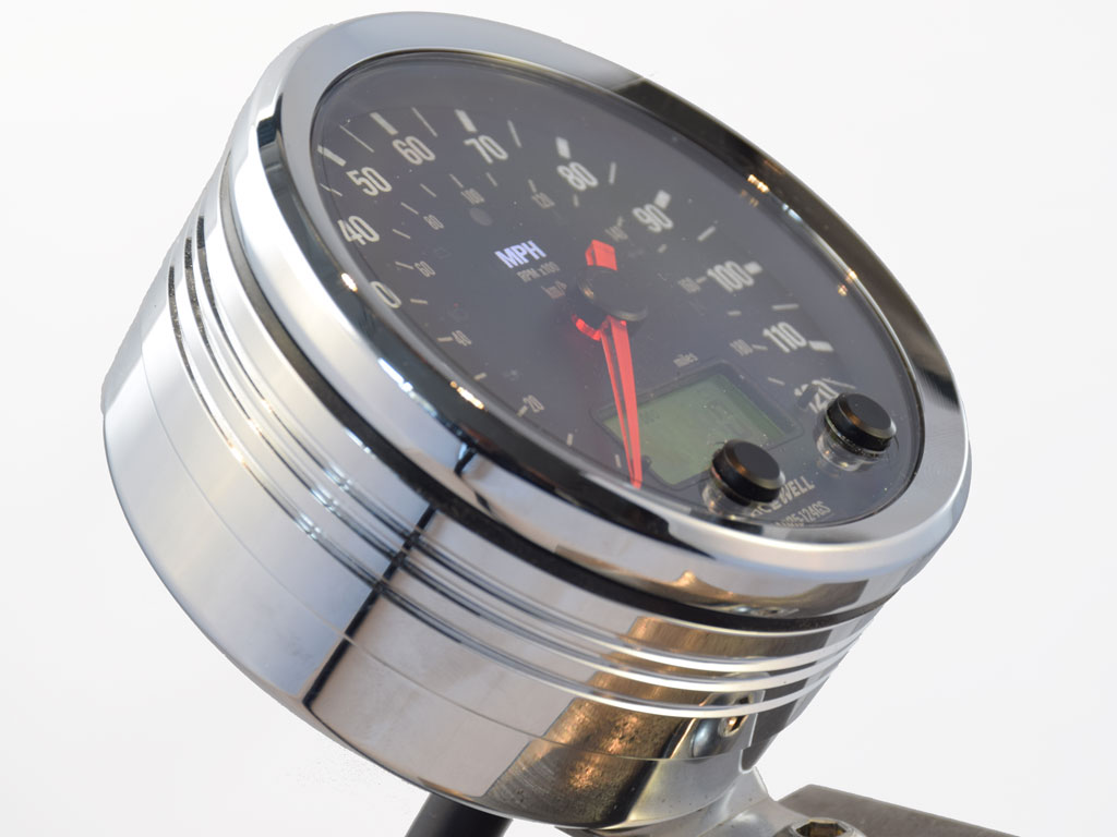

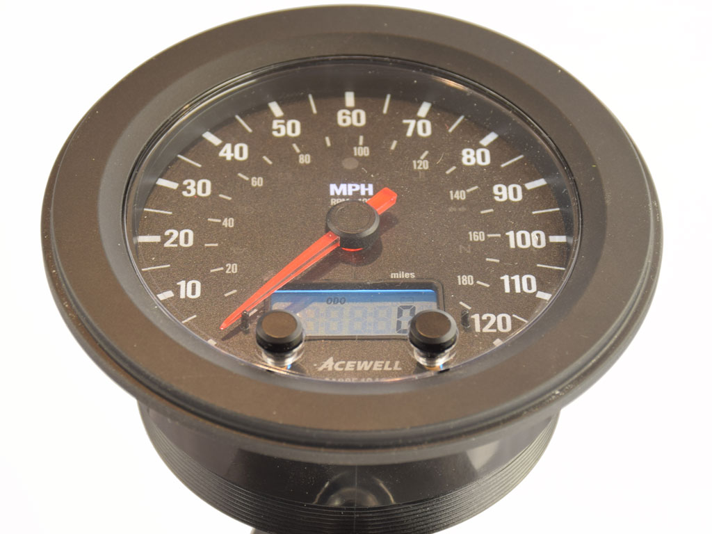

I'm umming and ahring as the better fit for GG's dash hole is an ACEWELL. And, as I have pointed out before, my experience of AceWell has been thus far less than ideal.
Still one has to be open to change.
Marketed for BMW's but it'll be an easy fit.
For R3's more options.
Speedo and tacho in one device.
