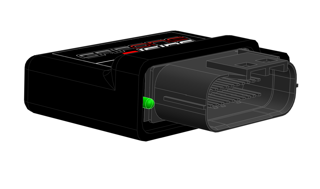

Rapid bike makes one.
Gripone also,
No idea as to their efficacy or how extensively modifications need to get to make them work, but it's not plug and play.
