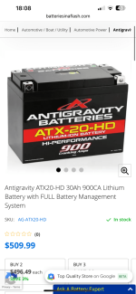

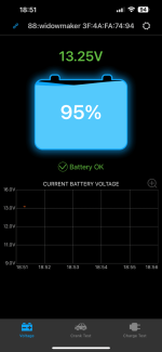

7yrs on my Anti-Gravity, stock regulator. Never a problem, ive had it turn off one winter being in storage, but two weeks later it turned back on and charged as usual, It cuts off at a set voltage to save from discharge. High compression no problem, 900cca on my anti gravity hd. 7yrs and going strong, worth every penny to me, just knowing its gonna start! I can leave my key on and run the stereo 20 minutes and not worry about it starting. I do have led jw speaker headlight and led bulbs in rear light.

You must have more room on the first gen. Rocket. I just measured mine and the ATX 12 is as big as I can go. The 20 is 6.9 inches wide. The other dimensions are there same though. Shame. looks like they put a fuse block or something there on the new ones. The 20 is only a couple of bucks more too.
Yeah, battery box is larger
