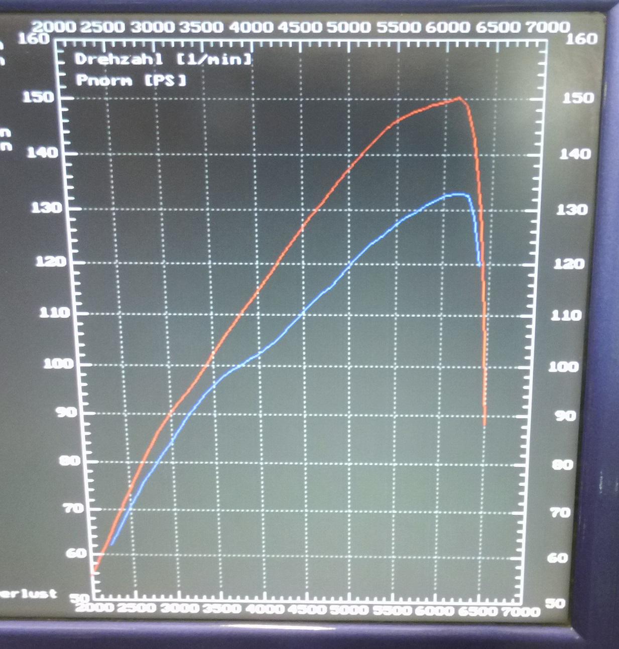

Zard Penta blue
vs
TORs red
(TORs without crossover pipe.That would have been about 10 hp more.)
@Penner Just out of curiosity, where do you think the loss comes from? Lack of back pressure and pulsing since they are so short?
When i first got my R3R, I was looking at the Penta until I saw they wouldn't fit with the ABS underneath. Even though the R3R is gone now, quite glad I couldn't buy them lol
As the exhaust has EU-homologation and hardly any volume to reduce noise emissions, they had to baffle it extremly.
I think, that is the main reason.
And these exhausts are not made for performance. It is all about looks and sound.
They don´t dyno them.

Noticed DP has increased the price by £100 recently not a small increase! Mr Penner please can you recommend an available tune ecu map for my current set up please? Zard full system 3x K&N’s on a 2004 standard, many thanks in advance.
Sorry, no map. I just had a Roadster with this configuratoin.
The dyno graph was much better than with the Penta. But not quite as good as with stock exhaust and a good map.
So I think, that a good derestricted map could do the job and just run a little rich.
In the long run you should get it dynoed.
