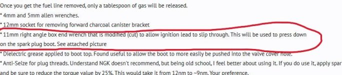

* 11mm right angle box end wrench that is modified (cut) to allow ignition lead to slip through. This will be used to press down
on the spark plug boot. See attached picture

9) Drop the boot into the hole. Now take the 11mm modified box end and position against the top of the rubber cover (see pic). Now use your weight to press down until you hear a "crunching" sound. This is the threaded terminal end moving through the spring. When you hear the crunch stop, you've got it. Remove the wrench and notice the rubber cover in the hole. It should NOT be flat, but pushed down somewhat into the hole (see pic 'Seated vs Not'). In the pic, properly seated is on left, not seated on right.

Could you provide details on the modified wrench for boot installation?
It's in the initial write up, grabbed the section for ya.
