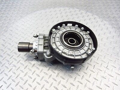

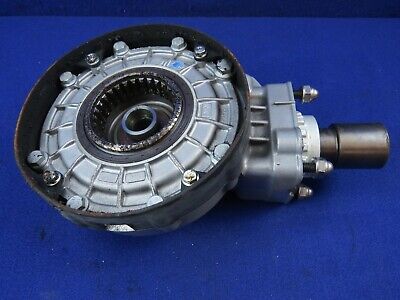

Here are a few used in USA on eBay.
2011 05-16 Triumph Rocket III Touring Final Drive Gear Differential Hub OEM
US $444.09
Shipping:
US $158.87 eBay International Shipping.
US $429.00
or Best Offer
Shipping:
US $134.49 eBay International Shipping.
09 Triumph Rocket III 3 Touring final drive gear hub differential
US $517.00
Shipping: OUCH!!!!
US $342.25 USPS Priority Mail InternationalTM. See details

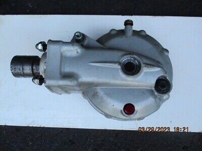

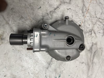

Wow this seems a great deal here in Oz on eBay.
I have sold a couple of diffs in the past all Au$700 up!
I have bought a few thing from this wrecker before, no problems and that cheap postage on a 25lb, over 10Kg lump, is a bargain!
www.ebay.com.au
TRIUMPH ROCKET 3 TOURING 2008 DIFF | EBAY
TRIUMPH ROCKET 3 TOURING 2008 DIFF -- GOOD WORKING CONDITION -- OPEN 6 DAYS PICK UP OR DELIVER EFTPOS PAYPAL
www.ebay.com.au
