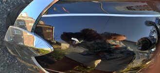

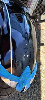

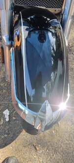

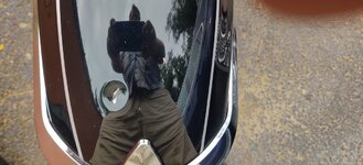

Mine you can't even tell, I wish I did a before and after pics, but I basically did the same thing on a dime size dent I had on the top of the front fender and here's the photos, not perfect, but if you didn't know it was there you'll never pick out the imperfections, I polished it with a rotary polisher and burned through a little, so it's a little wavy. Good luck, the paint will probably cost you about $100 with reducer, but it's a urethane paint and really matches good and you'll have a lot more for when the other varments come to town, can you say GRAND KIDS🤣😛😜😉🥺
