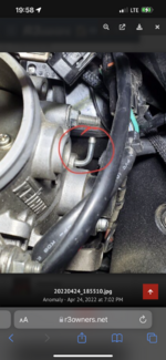

I did just find this random hose barb. I don't see a hose that it should go to, so perhaps it's supposed to be capped. I also didn't see it in the service manual, but that manual isn't a short read and it is entirely likely I missed it. I vaguely remember a black 1/2" rubber cap and a silver hose clamp, but I could be remembering another part of thr engine or even another bike.
Well I found this pic online of a used throttle body assembly. I grabbed a piece of clear hose I had, filled one end with hot glue and zip tied it on. If it gets rid of the hiss, I'll grab a high temp hose and force a ball bearing into it for a cap.
Out of courtesy of my neighbors, I'll wait til it's light outside before I fire it up again.
Well, that wasn't it. Still getting a leak with that part capped. I'm looking for my usb-c adapter for the tuneECU cable. Not sure how much that'll help, but I'll try just about anythin' now.
