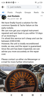

There are a number of alternatives on the market but they don't fit the looks of the Rocket much.
MPH Speedo/odometer black face taken from a then new Rocket can be sourced for USD 457 including postage to the US, a repair to an old unit ended more expensive as we learned on this very forum.
