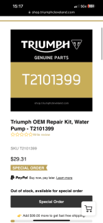

usually at first break down the mechanical seal therefore there's a hole under pump whereof coolant drop out and tell you for the broblem " Mechanical seal agreement expiring"
Triumph sell the spare parts = its NEW WATER PUMP. who now needs a new pump? When you can replace NEW seals:sadwavey:
If you get damage on water pump "wing" impellor so will not leak from the hole. I can not find no reason for it breakdown? What kind of damage you mean?
but a handy man fix it as well:mrgreen:
so the impellor has nothing to do with this seal issue.
