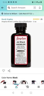

TY AstroRocket, my buddy showed me this stuff and changed his from tan/brown to Dark Brown, 3 week's ago and likes it, no bleed, it also has a deglazer cleaner prep jar, my buddy said just dry it in the Sun before you do it and it soaks it right up, 2 coats cross pattern,

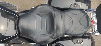

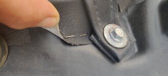

, hope to find someone with a good experience cause mine has the color completely down to grayish white on a black seat, see photo. Still investigating, do you know what kind/brand dye you used?? TY
Nevermind it's vinyl!!! Looks like fabric underneath.
So I guess the new question is has anyone painted there vinyl seat, does it last???
