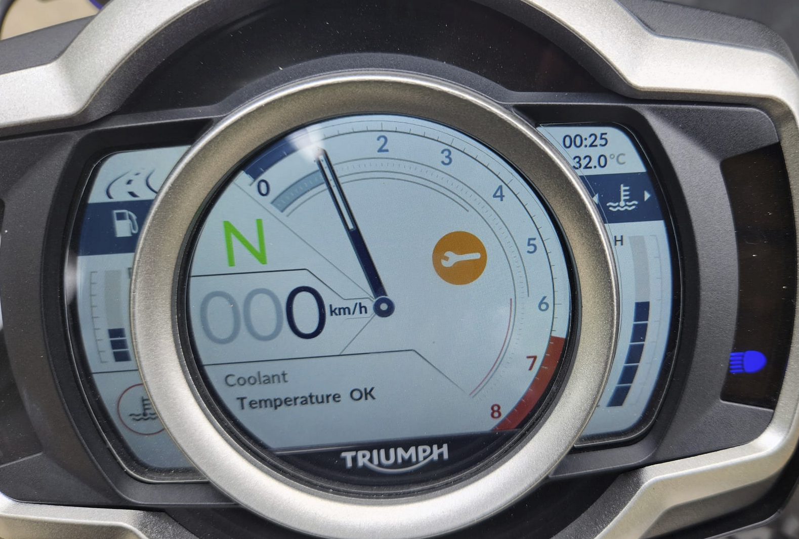

After reading your post, I noticed my temperature and it was one bar above half at 32C 89F.
