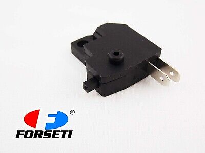

2300 or 2500? On the new 2500 The front brake i believe has a switch that can get snagged by a rag or something like that, @Nashvegas had this problem i believe, something about that switch getting messed up.
Check the switch on right handle bar I have replaced mine twice ( there pretty flimsy). I got mine here
