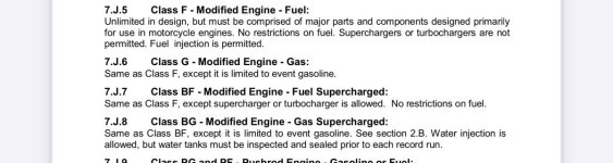

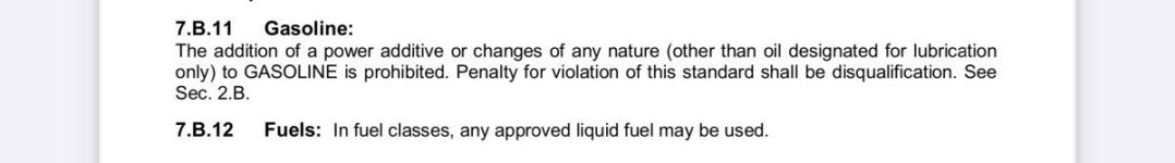

Great job man! 150+ on a big nekkid bike is moving! A little nitrous would be a fun way to pack on a few more mph, if you want to do it the easy way. :) Just puts you in the fuel class, instead of gas.
thanks Spaz, weve got some ideas on somethings were wanting to do for October. It was a real hoot for sure, right out the box i threw my dart backwards and at 130ish it wanted to flip around and get right, so my cg was definitely off😂. I had to go pretty hard out the box to get the big girl up to speed for my final run and believe i can improve on this, i have throttle left everywhere its just getting it applied and not messing up other stuff during the run. Gonna travel across the country on trips, putting down miles, then after i return from a trip out west in august after touring her around im gonna get her dressed back up to go fast😬. Its fun having a tourer that can throw down in the wild on pump gas and then go lsr. Looking forward to watching you push big numbers this year! They said the motor was to mean sounding to be in the up to 3000cc class 😂
