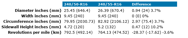

with 80mph being round 3000rpm, changing to the 2.50 ratio would drop revs to 2631rpm @ 80mph
done some quick maths & interestingly the final drive ratio appears to kind of take the tranny gearing (when in 5th) out of the equation. think 5th is around 1:1 ratio anyway
take a Metzeler 240/50 R16 rear tyre. 16" is 406mm, plus the 50 aspect ratio on a 240 section means 120mm tyre depth to rim. 406+120+120 = 646mm overall rear wheel diameter.
circumference C = 2 TT R, so in this case C = 2(22/7)323 in mm
=2030mm
=203cm
1 mile is 1,609.34m or 160,934cm
so the rear wheel must rotate (assuming no slip) 792.78 times per 1 mile
since we are talking about 80mph as the example then the rear must rotate 63,422 times in 1 hour so that's 63,422 RPH @ rear wheel
or 1057 RPM @ rear wheel
now - final drive ratio based on 13/37 is 2.85, so engine is running 3000 RPM, divide that by the 2.85 ratio gives 1052 RPM @ rear wheel
5 RPM difference in results going about it in 2 different ways
change the 2.85 to 2.50 and that should work back to 2631 engine RPM @ 80mph
I'm lazy but found a way to check some of your maths:thumbsup:. Does anyone know the maximum tyre width and/or aspect ratio that will fit the stock rim and swingarm setup? Maybe better and cheaper to go aftermarket rims like IMFASTOO has to get a wider choice of rear tires.
240/50-R16 vs 240/55-R16 Tire Comparison - Tire Size Calculator | Tacoma World
Tire Size Finder (optional):
Stock Sizes
  • 255/75-16
Plus Sizes
  • 255/75-16
Accepts P-Metric and Inches
Current Tire Size: / R
New Tire Size: / R
Your Calcs (x):
Side by side Overlay
240/50-16 240/55-16 Difference
Diameter inches (mm)
25.45 (646.4) 26.39 (670.4) 0.94 (24) 3.7%
Width inches (mm)
9.45 (240) 9.45 (240) 0 (0) 0%
Circum. inches (mm)
79.95 (2030.73) 82.92 (2106.12) 2.97 (75.4) 3.7%
Sidewall Height inches (mm)
4.72 (120) 5.2 (132) 0.47 (12) 10%
Revolutions per mile (km)
792.5 (492.43) 764.13 (474.81) -28.37 (-17.63) -3.6%
