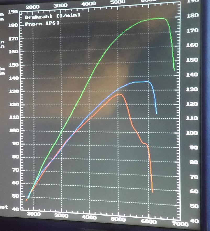

Get an exhaust can (absorption), let more air in, get rid of ecu-restrictions and the afr right.
You will get an overall better performance.
If it is about good low- and midrange - add high compression pistons plus torque cams and you will get this:
Cylinder head work and headers will add power at high revs.

200-205 possible with cams, pistons,good exh and inlet. Stock valves/springs/head. The cheapest way to get better performance,(that was his question), is a quick action throttle..... like 12 bucks
