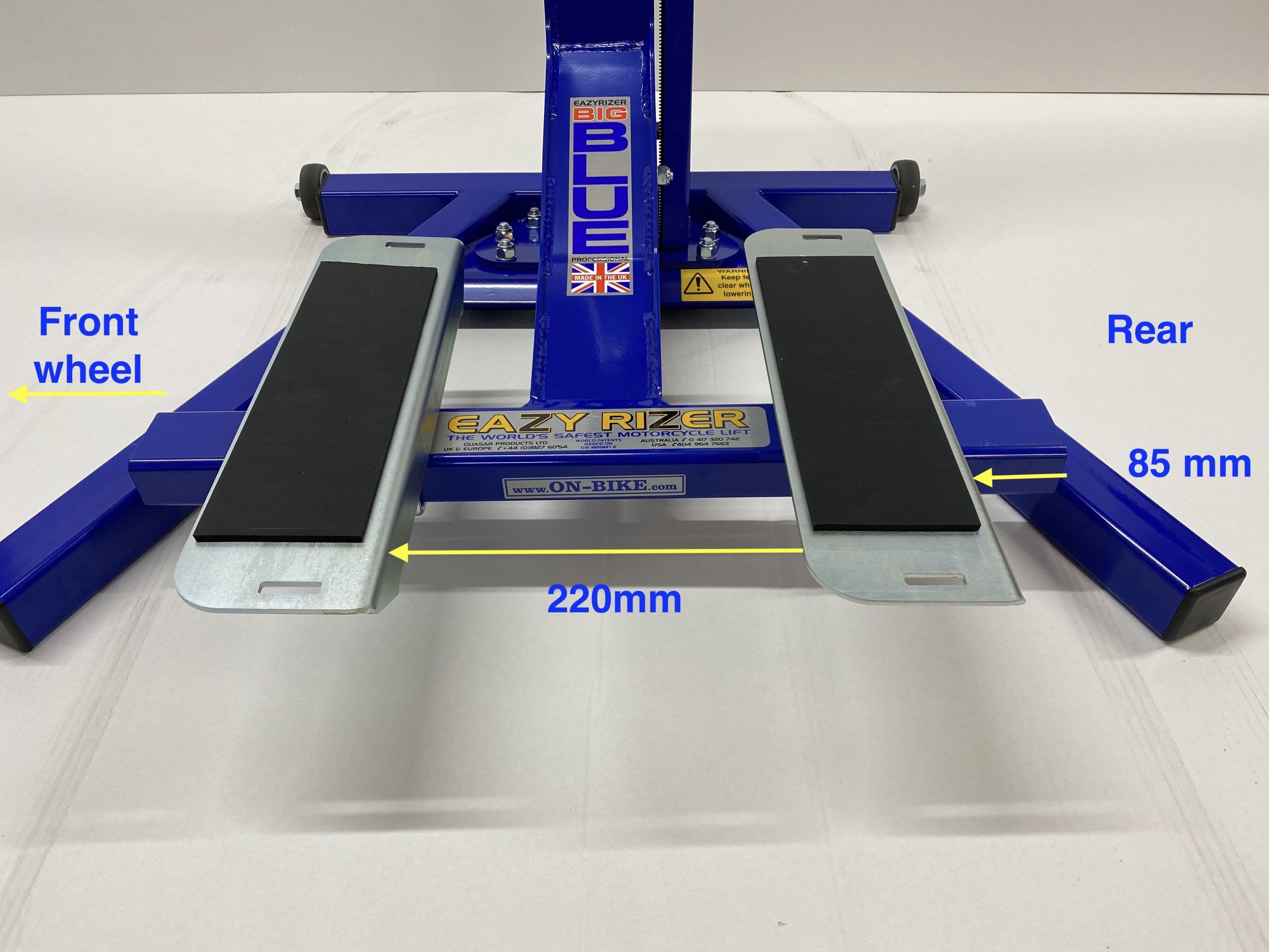

I have the same lift and used to lift my 900 pound Can Am Spyder without issue. I purchased a Big Blue Lift to lift the Rocket and Indian Challenger. Not at the same time, of course.
