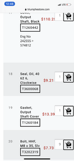

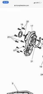

Torsional damper oil gasket? When you can check to see if you have oil on top of starter, check the 8mm bolts on water pump, they will loosen, easy on them only 9nm I believe
#18

Mine had a seal in starter drive to keep oil from going into starter armature, also has small vent tube to allow any leaked oil into starter to drain out. I assume this is standard for all Rocket starters.
