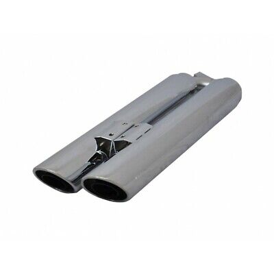

I would just get these | Pinwall Cycle Parts, Inc | Your one stop, motorcycle shop for used parts, service, accessories, & apparel
And cut the baffles out and see how you like them, I have the TOR's with the de-cat crossover pipe I just got on ebay from Poland for $220, and it didn't really add that much sound, a nice growl, I put a Link on YouTube before the crossover pipe and after with a new tune, Nell's tuneECU hex MAP, the tune is really nice but I think it needs to be tweaked, I'll tell you later when I take it in, but I don't think the bike is really loud.

These are mostly not for the touring, I think they show the TOR's and D&D, but I think you're looking for the Jardine's, I think I saw a used set somewhere on here for $1,200 but that's with the different header and all, complete system, if I could afford it I would definitely go with them, I think the D&D's are just slip on's, no header and I'm not sure if a crossover pipe comes with it, the only one I could find was on ebay in Poland, so you have to add approximately $220 to the D&D's and you still have the same size header. Spend the $220 for the stock one's at pinwallcycle and cut out the baffles and dress it up a little, I don't know what you would use to make a clean cut around the inside to get the baffles out, a rotory tool would take forever and still wouldn't be too straight, if you can get your hands on a plasma cutter would be easy to do and just debur it, and hit it with some black heat paint or powder coat, I'd really like to know how loud they would be without the baffles and you'd have to tune the fuel air ratio, I bet it would be pretty loud though, but for about $600 or $700 more you can get a complete used Jardine system, get tuneECU a upload a map to it and it would look really nice and sound great and add I don't know how much HP and torque 😁, so you decide.

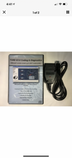

I got this one I gotta barrow a buddys laptop my family only has apple products and i guess there not compatible idk I’m not good with all this technology I got a list of tunes I’ll have my buddy put it in I can’t remember which one it is but it’s for the touring with tors and bypass and it completely unrestricts the bike

I heard you are better off with the cable right from lonelec, that looks like the one on Amazon and they are aftermarket. This is the one I have and it's been good.
It takes about a week to get it but it's worth it, It has to be compliant with the FTDi FT232RL chipset compliant, Top Quality UK manufactured circuit using FTDi serial chipset & premium components. Our lead uses an FTDi FT232RL chip and all components are sourced directly from manufacturers or authorised distributors. If not it won't connect to the ECU, plus I've heard of other problems.
Windows is no longer supported but it's free if you can get it, I think you can find it on here, make sure you put a charger on the bike I set mine to 2 amp mode and pull the headlight fuse, it needs a full 12.5 volts I think to work and if it drops out in between upload you can mess up the ECU and your bike, follow the directions and you should be okay, if you bought that cable on Amazon I would send it back, even eBay if you can and get the one from the UK total like $40 with shipping, but the wrong cable can cause lots of trouble I've read, it's not worth it, you probably paid like $35 for that one, $5 more dollars for peace of mind is worth it. Cause if it disconnects in the middle of an upload it can be very hard to get it back, and be careful of moving the computer or connections around cause I found them to disconnect very easily.
But the android version is like $10 on Google play, I heard they are not going to support the site after this year I think, but hopefully someone back's it up and puts a Link to it. But don't quote me on that, I'm really gray on that one, I just read the basics and info I found on here and YouTube there are videos that go through it, I got the has to be OTG USB to USB c adapter for my phone and I just got a Samsung Galaxy tab A from my girlfriend, I've seen them for about $50 on ebay, it just meets the minimum requirements to run the app, I think she has another one she's not using I can ask her if she would want to sell it, and I had to get another USB to micro USB OTG adapter from Amazon, but the android APP is a lot faster than the windows app or program, I've seen on YouTube, maybe find a friend with an old android smart phone all you have to have is a WiFi connection to download the app and map's, these are the system requirements,
Oops, there was an error! | TuneECU just about any android phone should be able to do it, but the phone or tablet has to be OTG compliant too, I just googled my phone specifications and how to turn it on, but I think by default it's on.
That cable works with the tune ecu app and a android device, the disc is for window, tune ecu app and that cable and 10 bucks and android and youre in. i think some still use the windows disc however. But that cable is good to go
