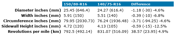

OK this is PURE speculation but.....
Under EU law a mfr MUST allow for a plus or minus 3% difference in tyre size as the law allows you to use tyres that have a circumference of plus or minus 3% against the original spec. Why? because even within a given tyre size there are differences between mfr's and tread depth makes a bigger difference than you might think.
I dont have ABS - but the oly way (so far) I've discovered is to fit a 140/80R17 REAR TYRE up front. It has to be mounted counter rotational. 140/75 MAY ALSO GIVE AN ABS FAULT - I DO NOT KNOW BUT IT'S NOT WITHIN 3%
